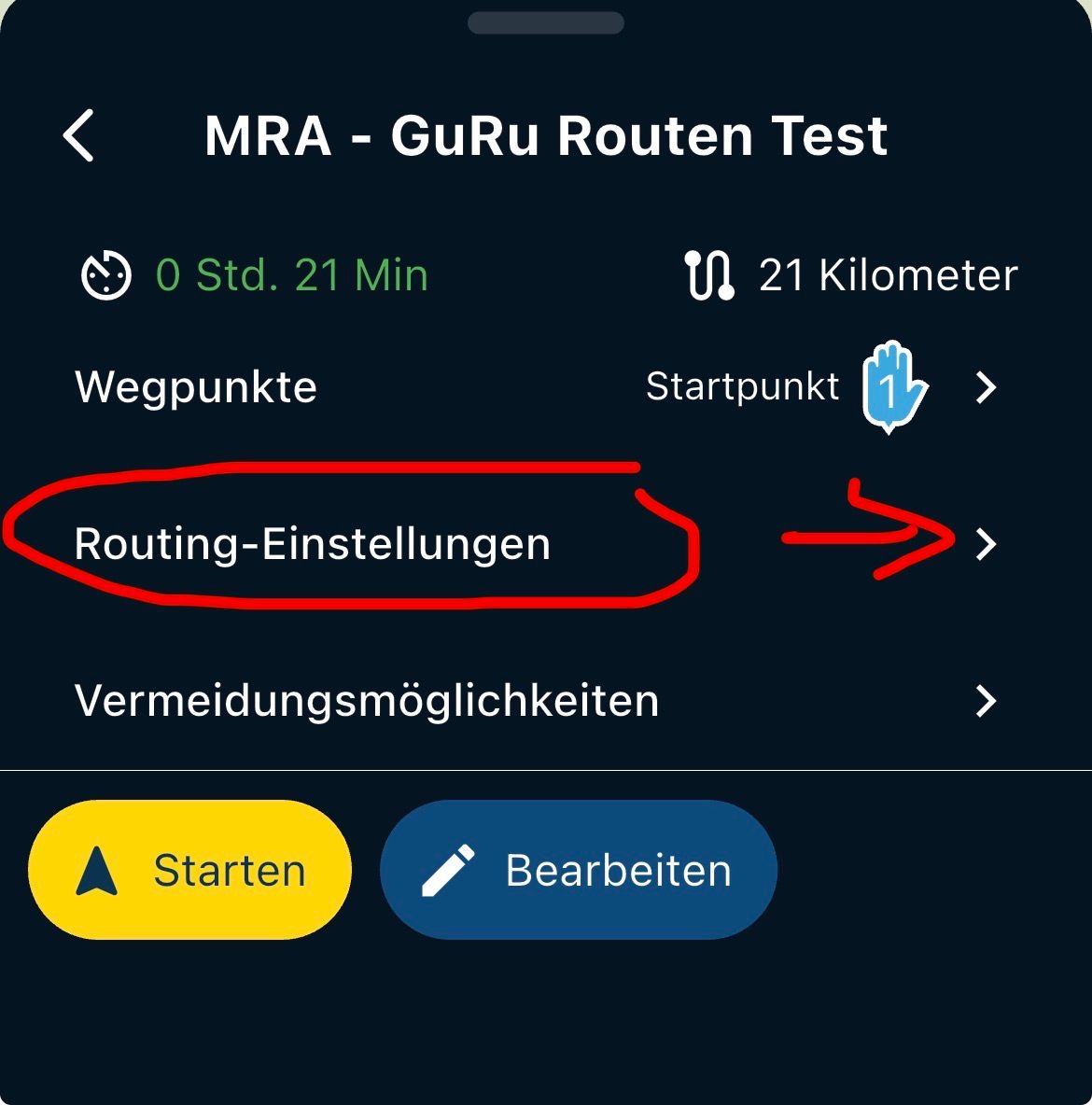

      @Montorsi-Paolo-0 Great to read that you are a fan. If you long press on any waypoint, all previous waypoints will be skipped so that navigation continues from the chosen waypoint. You can also use this method if you accidentally skip too many. Example, if you long pressed waypoint 7 but you are at waypoint 5, long press waypoint 5 to restore to your chosen waypoint.
        @montorsi-paolo-0 You also have the option to configure the navigation app so that, after a pause, it starts at the nearest waypoint relative to your starting point.
        Select the route and tap "Navigate," then choose "Routing Settings" from the menu and enable the "Start at nearest waypoint" option.
        Good luck with that!
          What Nick wrote works too, of course—and it’s always visible on the map display at any time. ...
