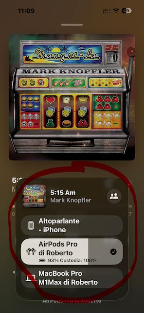

        @white.mouse Yes, I know, thanks. But doing so, you can't connect the intercom directly to the phone, as you can't use its native app with its features. In many iOS apps (Music, for example), you can select where to send the audio stream.I was hoping the same option would be available in MRA.
        I'll send you an example.
