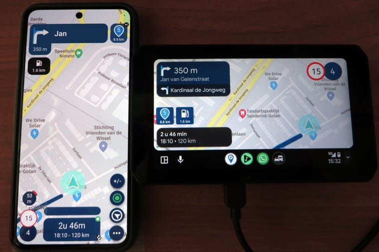

    Hi, last weekend I installed the new version of MRA, 5.1.0 - 462. According to the changelog there should also be information about the altitude on both phone and CP/AA screens. However, when I did a test drive this morning I didn't see it on my AA device. On the phone it is present. Below you can see a picture of both screens at the same time. How is this possible?

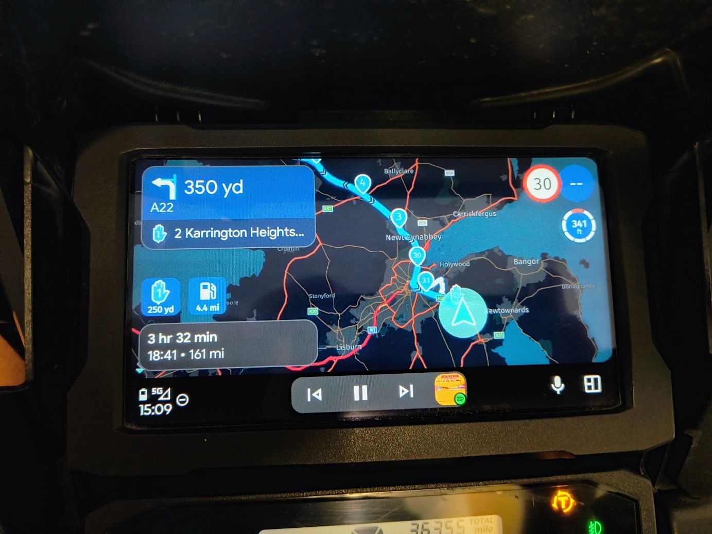

      Pops up on my Africa Twin AA screen.
      • M. Schrijver
        On my Goldwing screen also.
        Looking at the picure. It seems it is a small AA/ACP sceen. Maybe this has something to do with it. Not enough space?
        I don't know if there are requirements of limitations with screensizes. I cannot see in the picture but maybe the screen resolution is too low.

          My AA device is a Chigee Aio 5 Play with screen resolution of 1280x720 pixels.

            Configure androidAuto to have icons on left side so you can add a little extra space on botton. Perhaps is enough to see altitude counter.

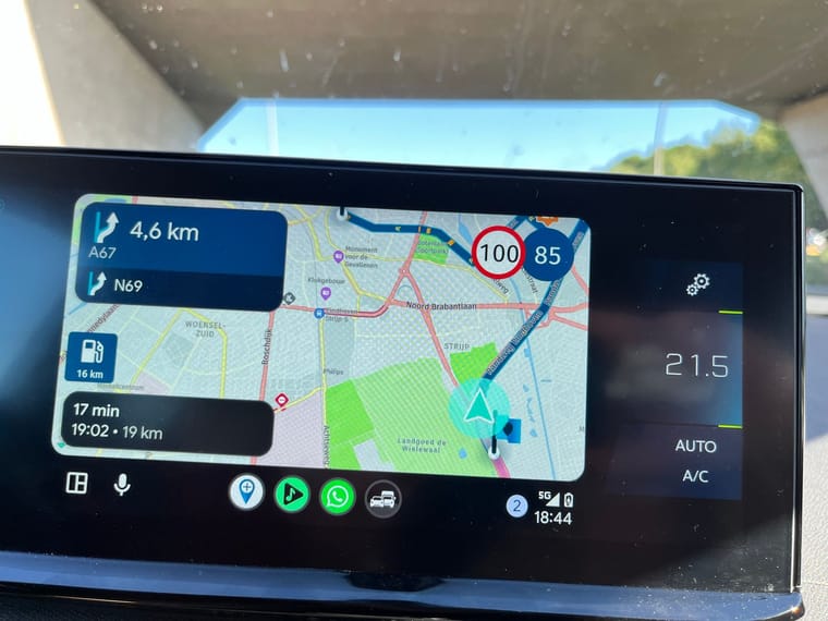

                  Today I also checked if the altitude indicator is displayed in the Android Auto in my car (Peugeot 3008). Different screen, same phone (Pixel 8). Unfortunately, it is missing there as well.

                    @Lluis-Arasanz Hi Lluis. Thank you for your reply. Unfortunately the task bar remains at the bottom after disabling the "Taskbar widgets".
                      It’s missing when:
                      • either disabled
                      • screen resolution to small
                      Please go to myrouteapp.com/support to create a ticket. We can check your screen dimensions and decide if that resolution could in theory support it.
