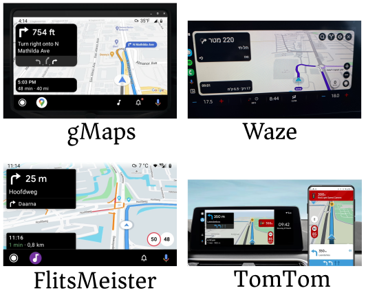

                          @Paul-Steinberg said in Restart not working after a stop with AA:
                          I'll disagree.
                          That's perfectly fine, but to illustrate I have put some pictures of the AA screens of some Navigation apps:
                          Don't you think they all look rather the same? That's because they are all bound to the same limitations, while the native apps don't.
