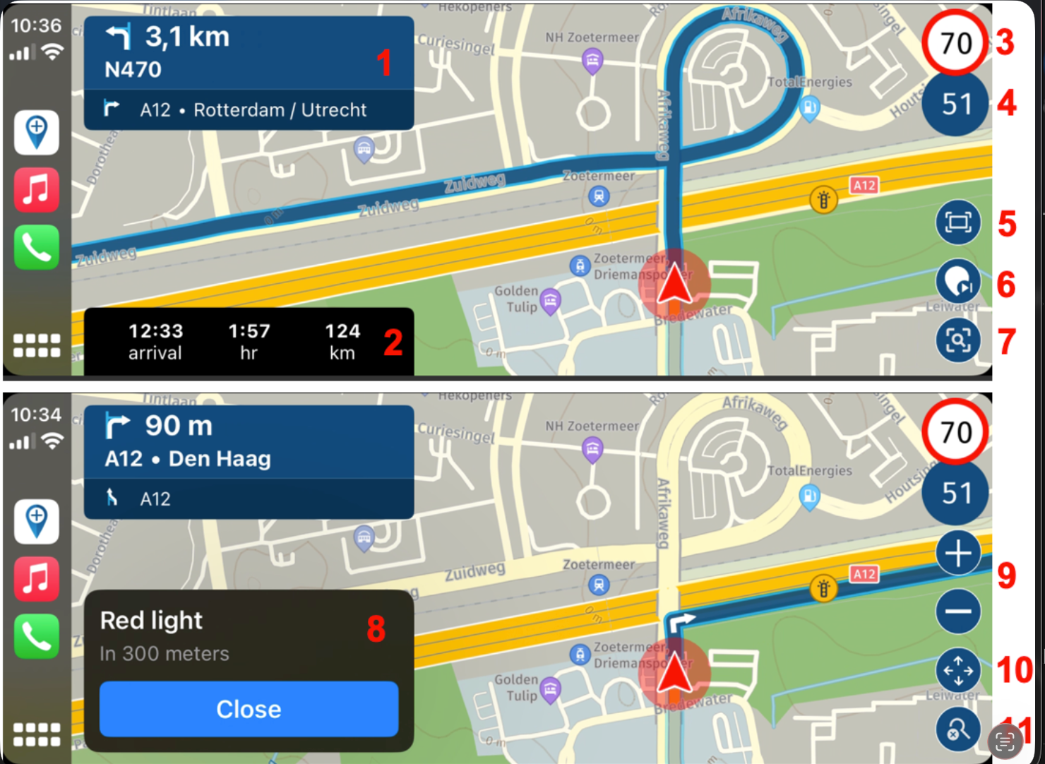

        Hi Marinus,
        Thanks for your swift reply! The buttons 5-11 in attached screenshot were previously available in CarPlay but were not today when I tried. Do you know what has changed or what the reason is?
        Many thanks!
        Marijn

            @Marijn-Laming might be missing if you are navigating a track or have activated the “navigate routes as track” setting.
