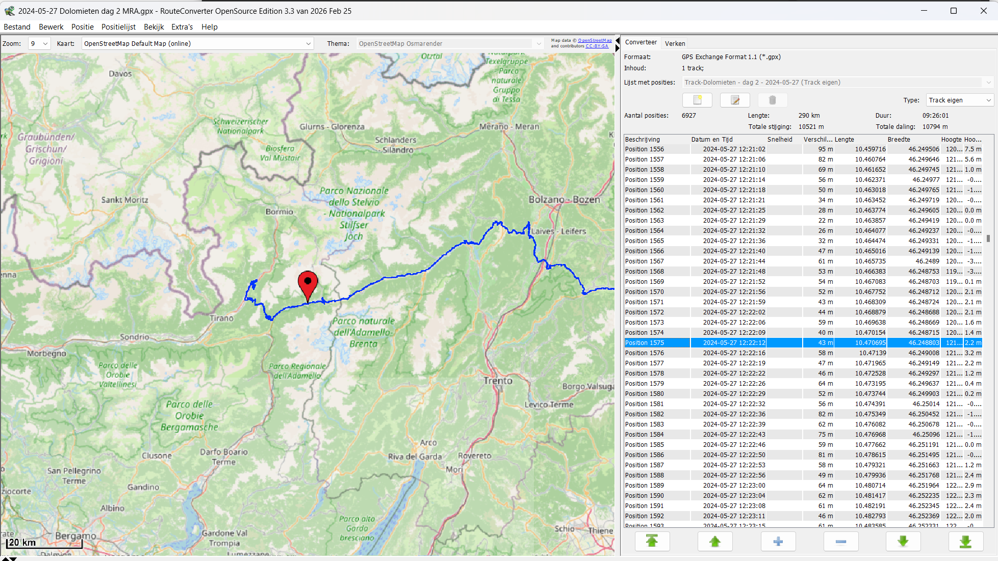

          You could use RouteConverter for this (www.routeconverter.com). It is open-source and freeware. You can click on the route and see the time and coordinates.

            I tried routeconvert. It gave lat and long but I didn't not see time.

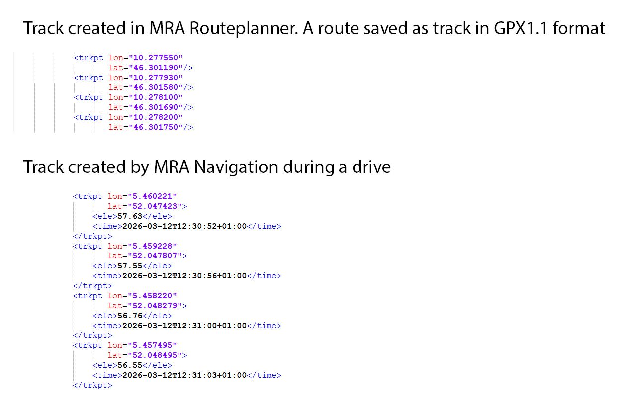

                @Lary said in Is there a way find out the time of a partular location on a tracklog.:
                There are two occurrences of 'tracks'.
                • The first one is the one you create in MRA Routeplanner. Based on a route you created earlier, you can save the route as track with type .gpx 1.1 (track, POI). These tracks don't have time stamps.
                • The second one is the track you recorded in MRA Navigation while you were driving e.g. a route. These tracks have timestamps and elevation.
                Probably you have used the first one.
